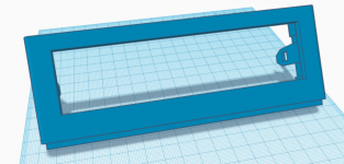

Note: the bezel in the picture below is not 360alaska's model!
But, while a bit flimsy (thin substrate and lacking the additional stability), about 6 months ago, I ordered a bezel in "White Natural Versatile Plastic" from Shapeways for $16 USD plus S&H and was able to install it without any angst. The texture was rough but it seemed to match that of the Q950 case somewhat.
It says nylon SLS, Neat!
I wasn't concerned (at least initially) with getting it perfect. I had an AppleCD 300 (external) that I wanted to mount internally and, not having any 3D modeling or drafting experience, this was just-plain good enough for now. Surely it could be built on and made more durable but I didn't want to spend more than $20 for more than aesthetics (at the time).

This should be my final revision of the open bezel:
Changes:
Adjusted size of the right standoffs
Adjusted size of the ends
decreased the dimensions of of the opening (added 8mm of material from the bottom)
At this point I've printed and tried at least 10 bezels to further dial in this model.
ABS, PETG, Strong resin, or Shapeways versatile plastic. You need something that is strong and also slightly flexible. If you are printing FDM it would be best to turn the models facing up, even though that would require a lot of supports, the top layer would be really smooth.
