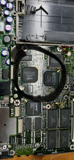

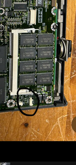

Probably regurgitating old info and questions about this special laptop lol. Picked it up, paid to much, and tore it apart to remove pram battery which had leaked a little. Other than that everything looks nice. Plugged in, dead, nothing… tore it down and check solder and power plug and all fuses etc. nothing unusual. I did notice an area of the too logic board seems to get warm, not hot, when plugged in. No idea if this is good or not. First pick shows where it gets warm. Second picture shows where there was a little battey corrosion on the plug. Any ideas what else to check?

is the cpu board actually present?
i'm not kidding when I say 2/4 of mine were missing the cpu
if it is, reseat it. make sure it's in there correctly. test by hooking up the speaker connector and plugging in power
also... make sure you're keeping track of those screws. you'll regret it if you don't...
using the wrong screws in the wrong places can and will drill holes in your bottom case

Lol, yeah the spoiler has happened unfortunately. It does have cpu card. Will reseat it again. Another question. The reset button was broken so i dont think it works. Could this be an issue for me to try a pmu reset? Will attach picture.

from the photos I dont see any really bad corrosion, apart from the darker area with the little PRAM battery connection socket..
