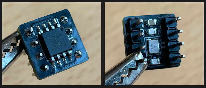

IT was the RTC IC - OMG! So the SCSI issue is resolved. Now to the Horizontal Bar logic board.
No sound...Socket are new, for the ROM and SIMM. Swap ROM with another working system, same behavior.
That’s great! But I don’t understand because you said you’d already checked this?
Yes! the machine will work, aparently the replacement RTC base on
has some timing issues. I put a original back, and everything work.
