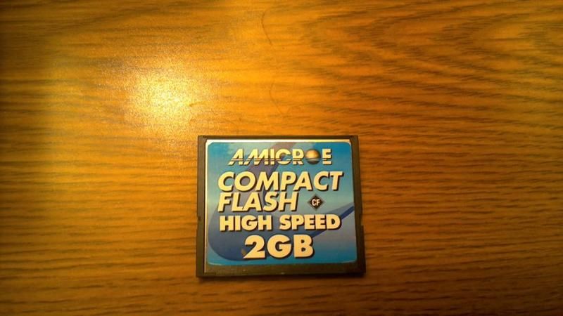

SegaDude, that CF looks old. Bought it used from ebay? It looks like it went through a lot of mileage! Question for you, SegaDude, you had Virtual Memory on with the CF?
