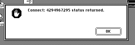

I have connected a vonets VM300-H to an old SE/30 with an Asante PDS Ethernet card. I’ve configured the VM300-H with my modern macBook (Bridge mode, half duplex) and connected it to my WiFi. When I connect the VM300-H to may SE/30s ethernet card I can access vonets.cfg and even the internet over my WiFi with the SE/30.
Then I installed MacWiFi (version 3) and it shows an WiFi entry with an empty name. Selecting this empty name leads to an connecting attempt by MacWifi (it says connecting…) but after that the connection to my WiFi is broken. Refreshing networks leads to en error, see screenshots.
The same happens without having connected the VM300 to my WiFi before.
Has anyone ever tried a VM300-H or only VM300?

Hey, I'm struggling with this as well. I have an SE/30 with Asante and the VM300. Haven't got them to talk to each other yet. I'd love to collaborate with you on this. My goal is to get my SE30 to tell my Tesla Model 3 which song to play on Spotify.
Which MacOS Version do you use? Open Transport? You can't connect to VM300? Is it a VM 300 or VM300-H? Have you set TCP/IP to DHCP server? How did you configure the VM300?
