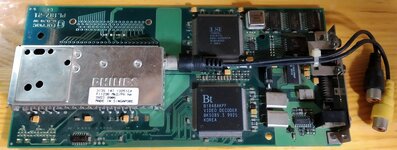

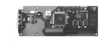

Then, there's the iPro RAID, which was delivered in two versions; one with an ultrawide SCSI controller and another which also bundled analogue video (/tuner?) input. (only one picture of this available) This card does use the mezzanine interface. I actually have one of the SCSI-only models in box, despite not yet finding an iMac to put it in...
