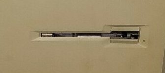

I know this is a basic question but when a Mac 128k is upgraded to a Mac Plus, what gets replaced?

Please see pic above.  Some people can tell by looking at the drive through the opening.  I am thinking this is upgraded to 800k.
Johnnya101
I have no idea what a 400k drive looks like, Ive never seen one in person. It looks like an 800k. Do you have an 800k disk to test? That will tell you quick what it is. Or, of course, just take the back off. Guessing you are looking at a photo of one listed for sale, so that is probably out of the question. Maybe wait for someone else to respond.

If Apple did the upgrade they'd certainly swap the 400k drive for an 800k one. Technically speaking Apple used to sell the 800k internal drive mechanism and the 128k ROMs with SCSI and HFS support as a bundle (you could buy this to turn the original "Fat Mac" into a 512ke), and I vaguely remember reading somewhere that the complete BOM for the Plus upgrade as sold by dealers included as sub-units the part numbers for the 800k floppy/ROM bundle and a motherboard/back-case bundle... but I don't have it in me to find a reference.
It's certainly possible some fly-by-night third-party repair shops might have been willing to sell you just the board, ROM, and back case without the drive mechanism, but the resulting machine wouldn't be a standard configuration. Heck, floating around out there you'll find examples of 128k/512k Macs that had the original rear bucket hacked up fit the different port layout of the Plus board, thus saving the need to find a replacement, but that's also obviously not something a real Mac dealer would do.

I don't yet have it but I will check it out when it arrives.  I will be restoring it back to a 128k so I am hoping it has as many original parts as possible.  It will be a long wait :(   Thanks for the replies.

You'd probably be better off looking out for another unit. Typically all they kept from the original was the front bezel, frame, and analog board, so you'll essentially be needing to find parts amounting to a complete 128k anyway. Are you at least getting the original short keyboard?
