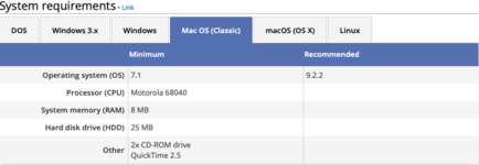

I'm on 8.1, I did manually assign more RAM to the program and have Virtual memory on. I'll try a lower OS like Forrest also suggested, from what I seen online, the game works on 7.1-9.2.2
Turn virtual memory off, use a lower OS version like Forrest and you said. If that isn't enough, if it doesn't need a CD, you could try booting with shift held down to disable extensions and see if that makes enough of a difference.
Thanks, I'll try that. It does need the CD, forgot to mention I'm loading the CD ISO off of an external bluescsi device. If those all fail (and I think the 7.5.5 will be the solution) then I'll try again with the FPU 68040 (when I find one). I'll keep everyone posted, won't be able to try until I've returned home from work
