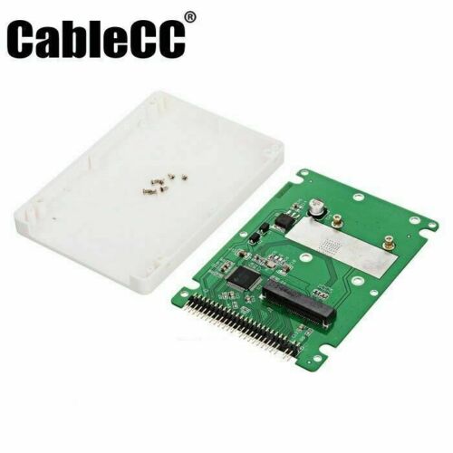

Tip 3: Get an SSD via an IDE to mSATA Adapter
There are several that can work but I've had a very good experience with these ones on Amazon (as an Amazon associate I earn from qualified purchases). Then you can get a 128 GB mSATA SSD on eBay.

Does your mSATA SSD in those el cheapo adapters overheat? My Mac Mini G4 sleeps (and eventually shuts down) after getting too warm.
davecom
Active member
Can you link to the specific adapter you’re using?
But no, I’ve only seen overheating on minis that were either not thoroughly cleaned, had a blocked airway for some reason, missing heat sink pin, or fan improperly installed. The SSDs actually reduce the likelihood of overheating. But maybe you’re using a different adapter than I use on the 20+ I’ve converted…
BespokeMan
Generic one from China with the JM20330 controller. I didn’t purchase it off of Amazon but it’s most likely the same as those that sell for around USD 13.
davecom
Active member
Can you show a picture? Many have JM20330 but they’re not all the same.
davecom
Active member
Thanks. I haven't had particular experience with that adapter, but it does look like the same ICs with a different metal heat shield than the one I use. I've had very good success with the cablecc product with the white case (also available under other brands). But as I wrote above I doubt the SSD is the cause of the overheating.
Here is the adapter I use on Amazon:
And here it is on eBay:
