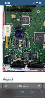

I think I can see some solder bridges near the serial ports.
Thanks. No I did not reflow, but I did notice of lot of these "bridges" (see pic below). Looks like some sort of white residue which could create some RF coupling, I agree. I tried to get rid of them all with the scrub, but I obviously missed some spot. Let me try that

@pinto_guy your white residue is just the flux reacting with you having put it in the dishwasher. Generally it's fine to leave it but YMMV.
There is a test mode that can be enabled via those burn-in pads on the top left of your pic - details here: https://web.archive.org/web/20140921020853/https://mac68k.info/wiki/display/mac68k/Diagnostic+Mode
Maybe that'll provide more details.
P.S: the test pads share a serial port with one of the miniDIN connectors, you can just use the trigger pin that goes to the via and interact with the machine via the miniDIN if more convenient to do so.

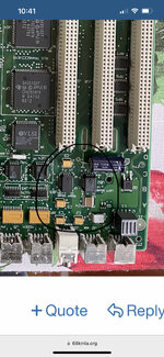

In my experience check all traces around leaky caps. I have also had to remove sound chip and clean pads, fix traces etc in this area. I
Thanks. When I replaced the caps, I did that, but of course I might have missed something. I might bite the bullet, remove them and replace again

So I tried again swapping the RAM SIMMS, inspecting traces, contacts etc.. I reflowed all the new Ta caps, and I still get the same result. I attach new high res pics of the bad cap areas. I actually looks as clean as I have ever seen on a vintage Mac board.
GRudolf94
The area around C10 and friends is a bit cruddy, not sure if enough to stop the machine working, but D5, Q3, UD13 and UE13, and the vias around them could all use some retouching with fresh flux. For the two HC132 I'd actually pull them to ensure you have no corrosion issues under the ICs.
