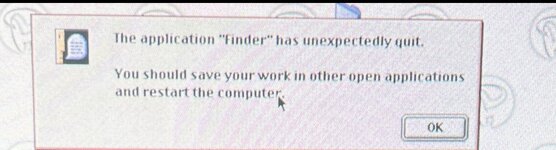

Hi. I flashed a Sun XVR-100 64MB with the latest Radeon 7000 Mac rom. (226, I also have 109 and 208 available). I'm getting some errors. On MacOS 8.6 with drivers installed, finder quits on boot (errors about crashing but never seems to actually crash). Adjusting resolutions crashes "Monitors and Sound", but still adjusts resolution. Can't open Diablo with Rave or OpenGL. (Crashes error 3). At various points, weirdness with display. (Shown below, moving window over screen with reveal) ATI displays sees it as a Radeon 7000 Mac.
Should I flash with older rom? Is this just to be expected?

Also, in MacOS 7.6 with the Dan Palma drivers, I don't seem to have any issues. (Not a lot of testing). BeOS single resolution without color or refresh adjustments (expected ish)

I think I found the issue. I had to disable Graphics Acceleration under the ATI displays menu bar panel.
Weird.

Attempting again to get it working. I disabled the QuickTime extensions and it still has the same symptoms. Finder quits unexpectedly on boot. Launching Diablo II or Quake II results in type 3 error and won't load. Monitors control panel crashes when I change resolutions.
When I turn off Graphics Acceleration on the Menu Bar icon for ATI, the symptoms seems to stop. I can still choose OpenGL and RAVE in games, and it seems to even work, but I can't tell. Seems fairly playable. Finder still quits because on reboots, it restarts the graphics acceleration.
Any other ideas?

Which version of ATI drivers do you use ?
I think that there is one which cause some problems (June 2005 one maybe ?)
