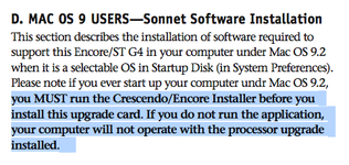

The manual is available from here:
http://www.sonnettech.com/support/downloads/manuals/encore_st_1800_qsg.pdf, among a variety of other places.
In there it has information related to the problem you have described:
This problem is well documented for a range of aftermarket G4 CPU upgrades, and there are a number of different solutions. Searches will turn up things like this:
