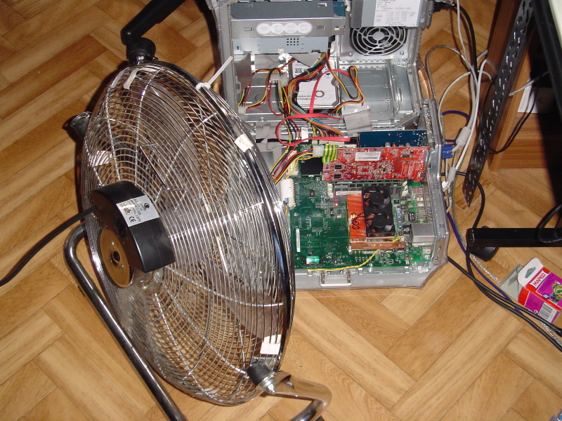

to check if it is indeed a thermal problem I would run it full speed with the case opened, then do some stress tests.
If theres no problem, it is heat related.
I once build a HackIntosh from my QS with an Gigabyte M-ATX board, 450W power supply and a GeForce 7600GT in it.
Did cut some extra holes and tried some different airflow ideas, but it still was cramped in there when closed I can remember..but I didnt have temp probs..lol.
