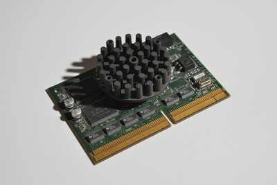

Hi. I have a PowerCenter Pro 210.(PowerMacintosh 7200)
It has the Catalyst motherboard, and supposedly goes up to a 60MHz bus officially according to my research.
I installed a Sonnet G3 450/1M. It all seems to work fine, but the bus runs at 45. (Makes sense 45 x 10). I was wondering if it's possible to have it run at a higher bus speed.

that crescendo is a fixed speed card which makes sense regarding having to clock the caches next to the cpu as well etc. and beside just about all apple-sold boards would only had been in the 40-50mhz range for most part so thast also what the accelerators are locking for to. a powercomputing-specific extreme[speed] accelerator might be really rare if they had ever been sold in the first place if you ask me?

Sonnet cards were pretty vanilla in the day with their upgrades often going for conservative bus settings for broader compatibility. I suppose most are still around and working which is good. You probably want any other brand with a DIP switch setting to experiment with bus speeds, notably the XLR8 MACH speed carrier card.

Sonnet's slogan is (or was) "No switches. No control panels. Simply fast." So their products are generally fixed and/or auto-configurating drop-ins. Apple slot CPUs have fixed oscillators on them that generate the bus speed, so it stands to reason that Sonnet cards do, too. This is how you can drop a 120, 132, or 150MHz CPU into the same machine (like an 8500) and it "just works:" the CPU dictates the necessary bus speed. Because Sonnet wants their products to go into as many systems as possible, they design for a middle ground, which in this case is a 45MHz bus. Most Macs and their installed RAM and peripherals will run stably at that speed.
