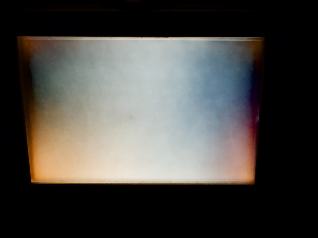

First startup I got the chime and some appropriate drive noises but the screen is just blank grey, no sign of a mouse. It doesn't look as splotchy in real life. It does change a bit in response to the contrast slider and the backlight, but no picture is evident.

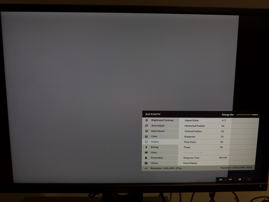

I was snookered by of all things the lack of a VGA cable, but when one arrived a week or so later I was able to hook it up to an external LCD monitor via the PowerBook Display adapter and DB15 to VGA adapter. It syncs enough for the LCD to see a signal at 640x480 67Hz, but still nothing but grey. I've played extensively with the trackball but have been unable to make a mouse appear on the external monitor, assuming it has extended the desktop which I think was the default behaviour.
I'm guessing I have to start opening it up but reading about how brittle these are I'm not keen if there is something else I can do. I'm still waiting on enough SCSI bits to arrive so I can connect an external drive to try booting from.
![](/bb/proxy.php?image=https%3A%2F%2Fi.postimg.cc%2FSRLKqK9R%2FPower-Book-160-Blank-Screen.jpg&hash=b7fbf338b5b9d7f64238ef1d3ebff31f)
![](/bb/proxy.php?image=https%3A%2F%2Fi.postimg.cc%2Fd1VR6MWn%2FVGA-Gray-Screen.jpg&hash=b0b8853f7e2b90215bb3bbf4dd796aab)
