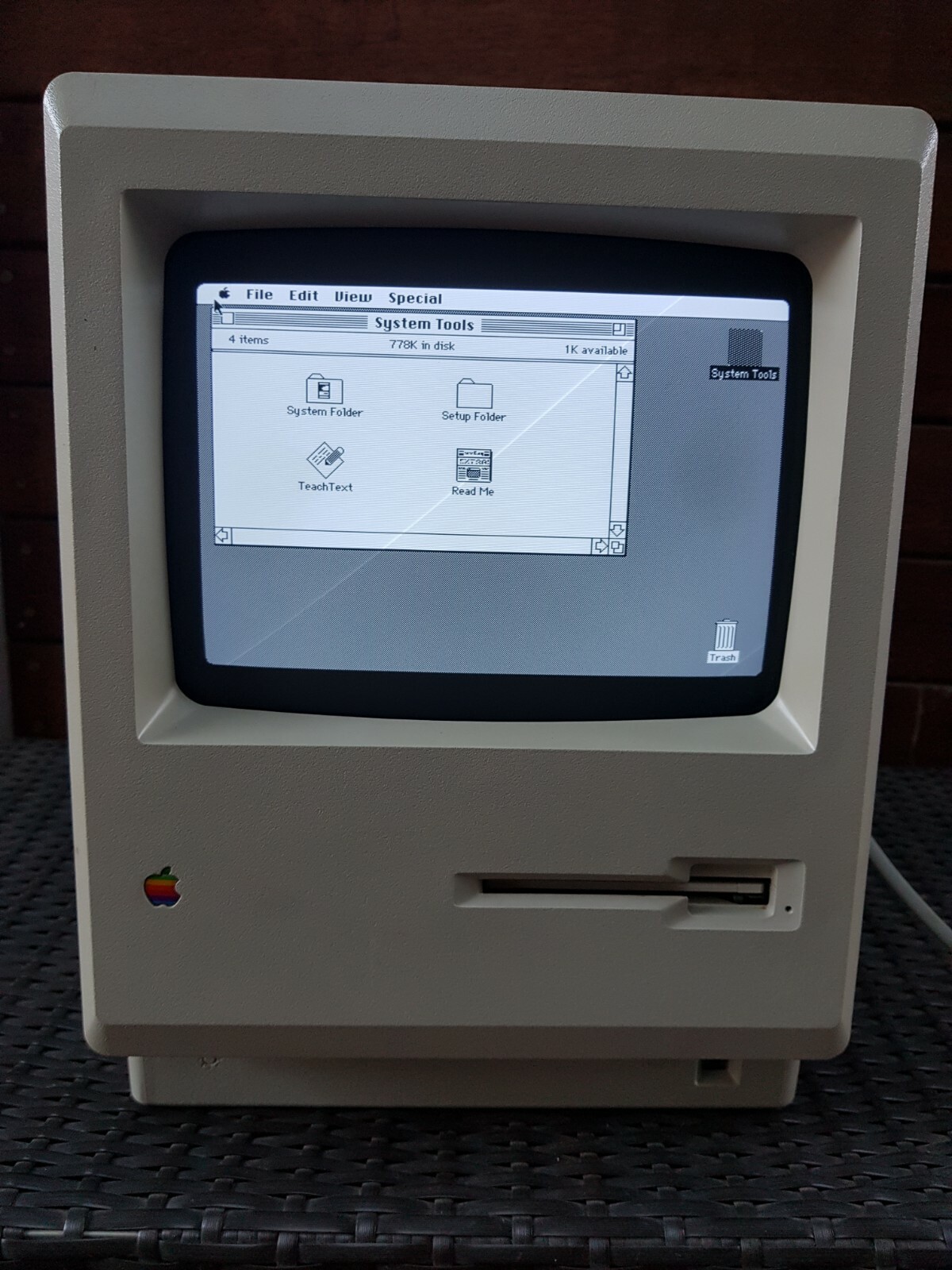

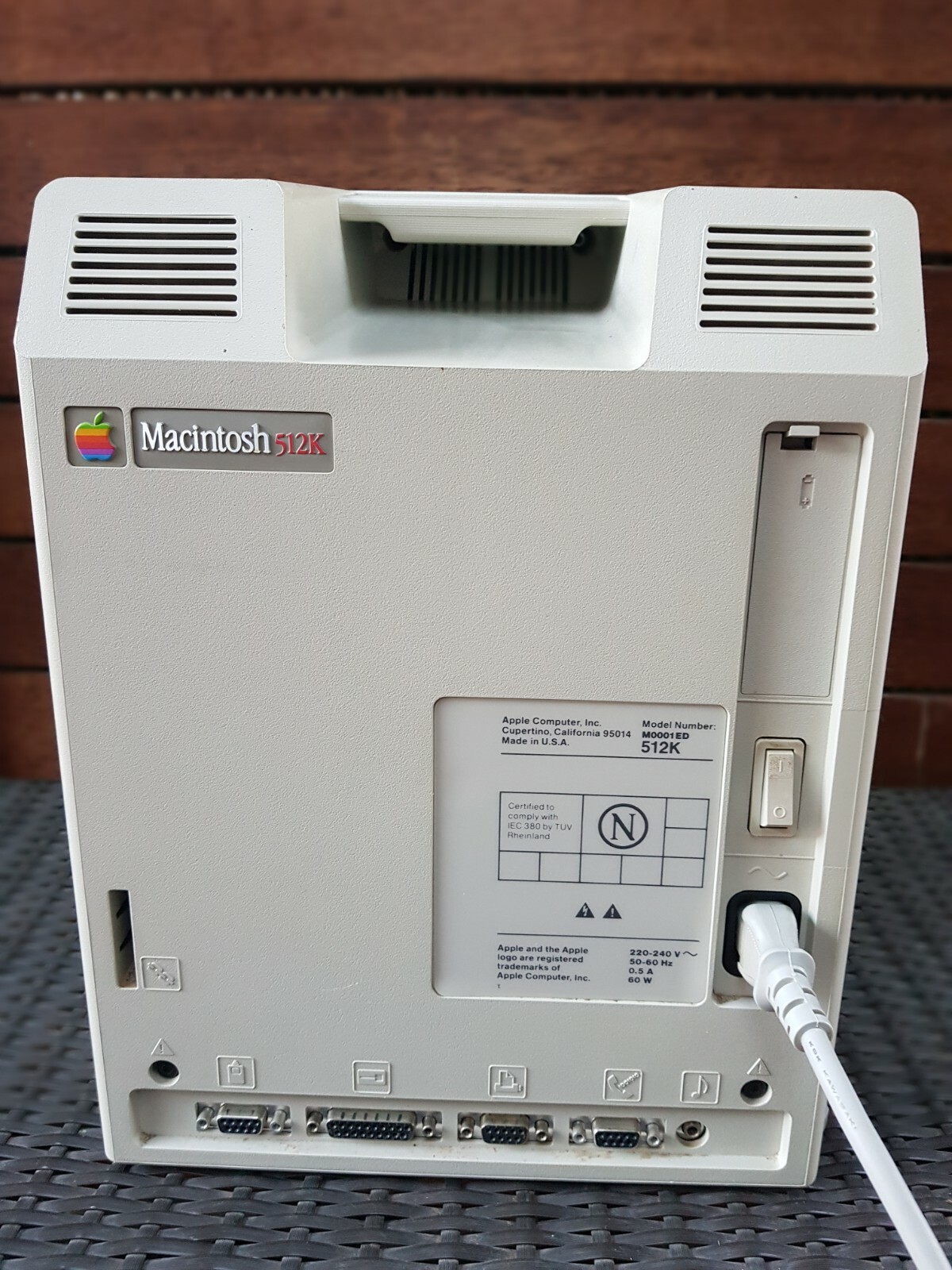

DeChief
Active member
Speak of the devil, this just popped up on eBay AU.
M0001ED, interesting.
