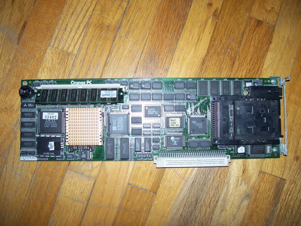

By luck I came across an OrangePC Nubus (can't seem to tell the model but it's a full-length card with a 100mhz DX4 on it) card and I installed it in my Quadra. I have the install disc for my OrangePCi 540 card but when I start the installer I get a bus error and the whole system restarts.
To make sure it was not the CD drive acting funny I copied the CD to the hard drive and tried again....same thing.
Is this an incompatibility with the installer or something? My only other guess is it probes the Nubus for the card and something is up with the card and it nukes the bus and kills the system.
Unknown_K
I think the 540 model is a Pentium PCI based one, so it would not run on a Nubus 486.
If you can take a picture of the card I might be able to help identify it. My 486-100 card has one PCMCIA slot on the end. I also have a full length 486-133 model which was the last Nubus one made I think (Model 340).

I have OrangePC 486 Nubus drivers (will image the disks this weekend when I dig them out), take a pic of the card so I can see what model it is.
CelGen
You ask, I deliver.
Unknown_K
Yea, thats the same one in my IIfx. Hopefully tomorrow I will fire it up and grab the drivers for it.

Don't think that model even had a breakout cable, is there a socket for one?
Generaly you shared the Mac monitor (either in a window or full screen), on some models you could do dual monitors with the breakout cable (340 model, etc).
CelGen
There is some sort of funky connector beow the PCMCIA slot. I'm really hoping though that it can just work Windowed so I can....and you will love this...
