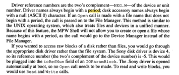

PBOpenDFSync fixes a long-standing wart (in my opinion; the fact they fixed it suggests they also thought this) where the Open family of functions decided whether to open a file or a device based on the name, which means that Open can't open files with names that begin with full stops (.), whereas the OpenDF family can.
Crutch
I never knew that. Then again, I guess I never knew how _Open distinguished between files and drivers. I guess I must’ve thought it was … magic?
I was reading about this just yesterday in Daniel Allen's book and thinking it was bonkers. Good to know I'm not the only one (and it was fixed)!
Yeah. There are bits of the earlyish Mac where you look at it and go 'oh, that's nice and sane', and there are bits where you ... don't.
_Open is definitely under the "don't".

Oh, that might explain why my virtual disk image stoped working after implementing this change; the program was writing temporary files starting with a period...
Yurp.
I think this is why A/UX's mac environment makes UNIX hidden files start with a bullet (•) instead of a full stop...
atommclain
"On Macintosh Programming Advanced Techniques", 1990
I currently reading through this myself, the chapter 4 FKeys to allow window and app switching are a god send, my only remaining hot key wish is to have a key command to move the current selection in Finder to the trash.
Crutch
It’s okay. It’s pretty MPW-tool-writing heavy which I suspect you (like me) will not find uber-fascinating. However the bibliography is maybe the best I’ve ever seen in a book. It inspired multiple additional purchases on many topics having nothing to do with Mac programming. The guy is clearly a polymath!
The discussion of the topic referenced above is really brief FWIW, on p. 75 of the PDF https://vintageapple.org/macprogramming/pdf/On_Macintosh_Programming_Advanced_Techniques_1990.pdf
