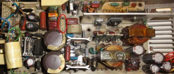

Hi all! I have a Macintosh II which I obtained quite a couple of years ago. When I tried to power it up the other day using the jump start trick, something inside the power supply exploded developing an extreme smell.
I now decided to recap everything, starting with the PSU. The blown component obviously is a RIFA metalized paper cap next to that green and red wired coil near the two large 820µF 200V caps. I am unable to identify its values, as the debris which should have the values printed on it just seems to be missing. The only information I can recover is PME271N and 40/085/56.
Is there a schematic for the Apple 699-0389 PSU or could someone please tell me the values of that blown RIFA cap?

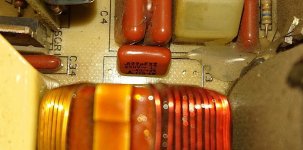

I believe this is it, Rifa PME 271 M Suppression Metallized Paper Capacitor
I just don't know what the values are for your part. Hope this helps, the image is just a sample.

Managed to shoot another Mac II with the same PSU now ...
For future reference, here's the solution: it's a  250V 22nF X2!
