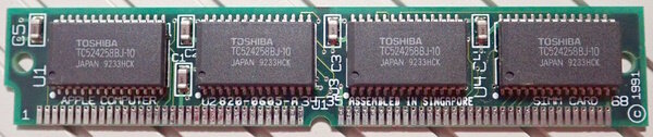

Delightfully, the LC II included a 512 VRAM stick from Apple. 820-0605-A. This supports 256 colors on a 13-inch monitor.
The memory slots were empty. Onboard RAM is 4 MB. So, I added two 4 MB sticks to bring the total memory to 12 MB (well, 10 MB due to Apple's software-enforced limit).

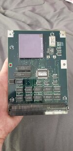

The whole point of this is to make use of the Sonnet Presto LC accelerator. This is not the Presto Plus -- this only has the CPU upgrade.
I was confused by the really old mask version and date code on the processor. The card was manufactured sometime in 1997 or later (see the date code of other chips), but the processor is from 1991. I guess Sonnet got a great deal on old stock 68040 chips.
Sonnet-Presto-LC-Accelerator-Front-Side.jpgSonnet-Presto-LC-Accelerator-Back-Side.jpg

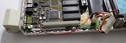

The last addition to this computer is a MicroMac fan. I purchased an LC III a while back that had this fan attached to the back. The seller did not include internal photos. So, I assumed there was a PDS upgrade card inside. It turns out the seller had pulled the card and sold it separately. So, I got played a little bit.
Regardless, the MicroMac fan is now being put to good use by cooling the Sonnet accelerator.
The power for the fan is drawn from the hard drive connector with a little piggyback cable. A nice touch.

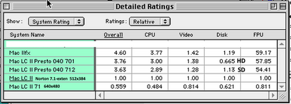

I ran various benchmarks, with and without the accelerator.
1. Even though the 68040 is a great chip, overall performance requires support from the rest of the board. The IIfx's 68030@40 MHz supported by L2 cache, fast memory, and a full data-bus outclasses the LC II's 16-bit data paths with a 68040@25 MHz.
2. With the Presto, performance degrades from System 7.0.1 to System 7.1.2 This is partially due to additionally third-party extensions that I used back then (and copied over to my MacSD).
3. The benchmarks supplied by Norton for the LC II were tailored to match the expected usage. That is, they used the smaller resolution monitor and they removed even some of the stock extensions. I guess that's not unreasonable if most users did so as well. On a computer with a fast processor and full data paths, the overhead of extra extensions is not significant. But, look how hard it hits my LC II (final row).

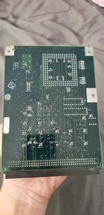

I have a similar card but its for a SE/30, does the driver work on this? or if someone here has them because this card wont do anything when plugged in my se30, just boots normal onboard 030.
