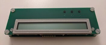

Anyway, nobody pays attention to wordy posts on their own, so have a picture of the other thing I've been working on, the "body" of TashFloppy:
It's a sandwich of two PCBs, easy to manufacture, easy to assemble, and in a Floppy Emu-like form factor. Cute, no?
