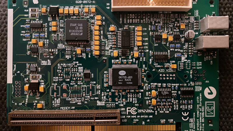

Images of Wings AV Card 820-0971-A below. Looks like this one could support the USB controller and a single USB port.

Thank you, @just.in.time . As I suspected part of the footprint to be populated is on the backside of the card. It should be easy enough to use the schematic I made for the Whisper card and apply it to this one.

All of my G3s (not sure about the AIO, though; I'll have to check) have at least a Wings card. Is internal USB possible on those? From what I've read in this thread so far, there are two revisions of the Wings card, and only one of them can do internal USB.
Also, would this be possible on the apparently quite uncommon Bordeaux card? Does anyone even have a Bordeaux card??

Two revisions of the Whisper card exist too. The later one is needed in both cases.
Looking at photos of it, it does appear to have the footprint.

OK, sort of implies that Apple was considering releasing an enhanced Beige G3 (or maybe something else altogether?), perhaps as a stopgap while production of the B&W ramped up, but then decided not to, yes?
Neat! Is it as hard to find as I think it is?
Although we don’t really know for sure, this explanation makes sense in my mind.
Seems like the revised personality cards may have started to ship with beige G3s around the same time as the iMac was released.
Alternatively, the revised layout could have been included just for prototyping purposes.
c
I do believe it is pretty rare - I haven’t seen many beiges with a stock DVD-ROM drive, which I guess is how you’d identify that a machine had one of these.
