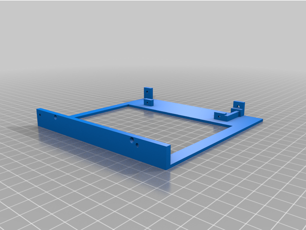

I'm looking to replace my G4 Cube's optical drive with a laptop-style SuperDrive and before I take a stab at designing one myself, I was hoping somebody out there had an .stl file for the bracket to fit it into the Cube's optical drive area. With cubeowner now defunct, I can no longer access the forum posts discussing this. I've attached a picture showing this bracket which I found on: http://www.atpm.com/12.03/cube.shtml

Here's one design I found:
