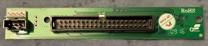

In the video, the IDE adapter he used had a connection for a laptop IDE connector and made a custom cable IDE cable. I wanted to make things a little simpler so I looked for one that offered a standard desktop IDE connector. In my search, I settled on this one that I acquired from Ebay.
Here is Ebay link for the part. Looks like the seller still has some in stock at the time I post this:
https://www.ebay.com/itm/2713400308...R5CuTba&var=&widget_ver=artemis&media=COPYthe
The reason I chose this one because this was the only one that I found that had the option to select the Master/Slave drive option via jumpers (more on this later). I also took a chance on this version since it was not a “slim” model and it stuck out more one one side. When I 3D printed the bracket, I soon discovered it would not fit with my choice the drive IDE adapter.

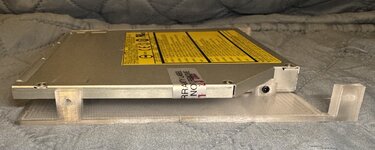

Here is the the drive screwed into bracket. I believe I used 2mm diameter laptop screws. The ones on the side were 4mm in length and 6mm in length to mount the IDE board.

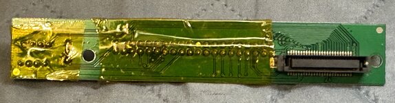

As a precaution, I before I mounted the IDE board, I used kapton tape on the side with the leads to prevent any chance of an accidental short.

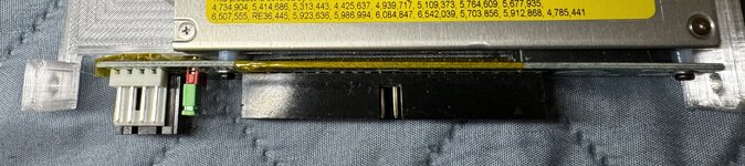

I needed some spacers for the IDE board, so I improvised them by cutting some PFTE tubing that I had from my parts bin for my 3D printer. This is how it looked when it was screwed in:

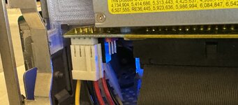

Next came to install The drive into into the computer. I have to give kudos to the original designer of the drive bracket. It fit like a glove in the G4 Cube. Here It is installed in my G4 Cube. I used the original screws from the old drive to install. I was concerned about width of the IDE board sticking out or not fitting because it was not slim, but I was relieved that it was not an issue and fit very well. Next to the power cable of the drive, is the IDE jumper. It is the green jumper. I currently have it set to "slave".
So, next came the power on test. I power up the G4 Cube, and IT DID NOT BOOT!!! It just hung on a grey screen. So I thought a little bit. I recall that the G4 Cube IDE cable had one cables wires was cut (if you look at the cable, it looks like there is a "hole" in the cable.) I recall in the past that in some IDE setups, the drives are set to "cable select" in which the cable determines if the drive is slave or master. Remember the jumper in the begging of the post? To test this, I went back to the jumper, and removed it.
I powered up the computer and….. IT BOOTED RIGHT UP! I went to system profiler, this what it showed up correctly with the correct ID number.
