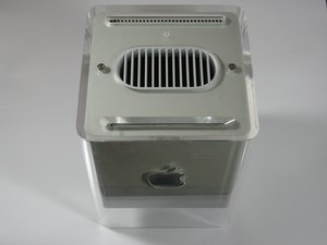

I've installed a Sony NEC Optiarc AD-7640A drive inside a G4 Cube (using a 3D-printed bracket). I didn't give much thought to drivers when I bought the thing.
Neither Tiger or Leopard can recognise it. And I can't find any Apple drivers online.
It's one of these, so was running on later Intel Macs. Is this a lost cause? I've a feeling this was a rookie error.

Are you sure it’s not a master/slave problem? I have replaced the optical drive in a few cubes and don’t recall ever needing a driver.
Does the drive appear in System Profiler?
François
As by default the hard drive is set to master, the optical drive should be set to slave (or ID 1). There should be a jumper on the little adapter board between the ribbon cable and the optical drive.
Thanks François. The optical drive adapter (green) doesn't seem to have a jumper but the one connect to the SSD hard drive (red) does. Any suggestions? Should I swap them round?

Actually I was looking at the wrong end. Jumper here, I think, but I don't know how to interpret.

csel means cable select, the master/slave configuration is determined by the cable, but it’s not supported in the Cube. Lo (low) is master and Hi (high) is slave, or is it the other way around?!
François
Turns out I have the exact same interface board: just remove the jumper, so 2-3 will be open and in the Hi configuration that would be slave!
So I've done that - and there's *some* progress. It now appears in System Profiler. But there's a DVD inside it - it happily swallowed it and I can see that the drive has power - but it hasn't mounted it.
Thanks very much, François - you solved my fundamental problem. It's half working. The Mac can see it and they're talking to each other. It ejected a disc quite comfortably when I rebooted and held down the mouse button. It's mounted a disc once. But it isn't reading it. And now I can't get it to accept a disc at all (I tried a different disc).
So there's a hardware problem somewhere? Either the drive is dodgy or I didn't install it properly - but if it ejects discs normally I'd expect it to accept them normally (ie it's not misaligned). Frustrating...
