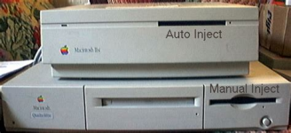

This photo will also help explain matters:
Manual inject machines have a curved groove on the bezel so there is room to push the floppy all the way into the drive, the manual inject drive does not have the mechanism to 'pull' the floppy into the drive, you have to push it in manually - hence manual inject.
A drive from a G3 will be too new, you want one from a Mac that used an auto inject drive.
The Performa one you have shown in your original post is also the wrong one. But the Classic one you've found would do the trick.
