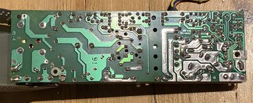

I have a photo now showing that C2 is 0.22uF. According to what you’re saying C1 should be 0.47uF.
GRudolf94
Additionally, we can juuuust see C2 is X2-rated. That 250V rating is cutting it too close for comfort on an UK line voltage.
Care to get us a pic of the underside of the board? That should allow for deducing how C1 is wired.
GRudolf94
Based on these guesschematics, they're both connected across the line, and as such should be rated X2 (or, even better, X).

I know I'm late here, but I figured I'd post this for completeness. I'm in the process of attempting to fix one of these Dyna Comps. Several of the parts have icky green corrosion so it might not be a fun repair, but I can confirm that C2 is X2 and 0.22uF +/- 10%. If I peel that piece of paper up a bit, I can also see that it's marked as KNB1530.
C1 is harder to see because of L1 being completely in the way, but I can also make out that it's identical, also 0.22uF and X2. Here are pictures.
