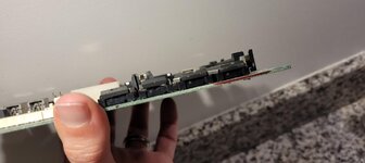

The logic board itself appears to be in very good shape. The battery hasn't leaked and I couldn't find any traces of leaking capacitors either. I did notice some differences in how the ROM chips sit on the board, see below:
The two left-most chips have a bit of space between the chips and the board. Could this be an issue? I removed the second chip from the left and re-seated it, but it doesn't seem to get any closer to the board than this.

Thanks for all your responses, very insightful! I've been reading about recapping. I'm not experienced with this stuff at all, but it's a nice challenge :) Indeed it seems I'm fortunate there's no corrosion on the logic board.
I'm still wondering about some of the ROM chips not sitting flat to the board (see photo 2 above), is this a problem? Since the pins are pretty long I expect it should still be able to make decent contact?
