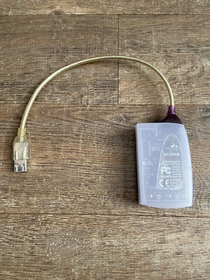

Alternatively, get one of these :
I don't understand why there are hardly any on eBay and they're that price. They're only really useful for this, and can be replaced with a cable. A year or so ago there were loads on eBay and at prices down to £5.
Hopefully you can still find one somewhere.
Anyone got any idea why they've all vanished off eBay? @joshc?
Serial midi interfaces are a dime a dozen, maybe a cheap macman for the Mac and USB midi interface for the computer? For MT32 the UM-ONE MKII is rock solid.
