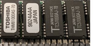

Take a photo of the RAM SIMMs so that the labels on the chips are readable. They might not be all the same, so make sure you can see all four (you could get away with just one of 1or2 and 3or4, but best to make sure they're not mixed up).

There are pics of the Simms. Probably more than y'all need but yeah lol. I'm assuming by the difference in size that the 2.5mb is probably right. But I'll let y'all be the judge.

That method of identification isn't definitive - it was designed for service staff and official apple parts. Note there are no 3 chip SIMMs which you sometimes find in SEs.
The only reliable way is to read the part numbers, look up what size each chip is and times it by the number of them. You need to be cautious because the chips have two dimensions - you might find a 1MB SIMM with two 4*1MB chips, or eight 1*1MB chips.
