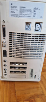

I asked for a picture of the back of the machine, since that wasn't in the listing. Curious!
