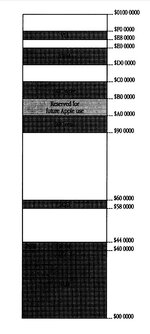

Just for anyone reading this, the SE ROM sockets have 17 address lines, so are 128k each for a total of 256k.
That means the Classic ROM won't fit because it is 512k. Not really a suprise since the added an OS in there.
The reserved space in that map is only 256k. Will the ROM actually be selected above it?
So reserved is 256k, but there is nothing immediately above it. My thought was you might be lucky. If the ROM base address is at the same place, and the decode logic gives echos of the SE ROM in that range, the next sequential address pin might be enough.
But, this is "prove me wrong please" logic. I'm not even at guessing level confidence. Pure hypothesis.

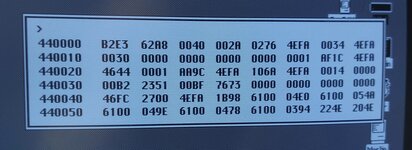

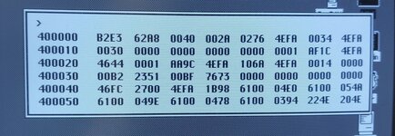

Sounds like time to crack out macsbug and have a look. Poke just above the ROM range and see if you get a bus error.
Hum. Something about my accelerator is stopping MicroBug from working. Pressing the Interrupt button just gives me this :
Ok, I can get to it if I press it after "Welcome to Macintosh" and before the accelerator's extension loads.
This is 400002A...
... and this is 44002A... It's different. Bah. I was hoping they'd be identical!

Ahha! @cheesestraws @Arbee! So I powered on my SE while holding the interrupt button, which is what you do to completely disable the 030 upgrade. Booted as a 68000, pressed interrupt again (doesn't crash now) and got the following - 440000 is a mirror of 400000! This means that adding the next sequential address line from the CPU should allow you to use a 512k ROM, because the ROM is enabled when reading 440000 (assuming up to just below 480000).
@bigmessowires - ROMinator for the SE? :)
It's looking like it just needs a custom board to plug into the two ROM sockets, and a mini clip or soldering a wire onto an address pin on the CPU (or somewhere else that it is available.
