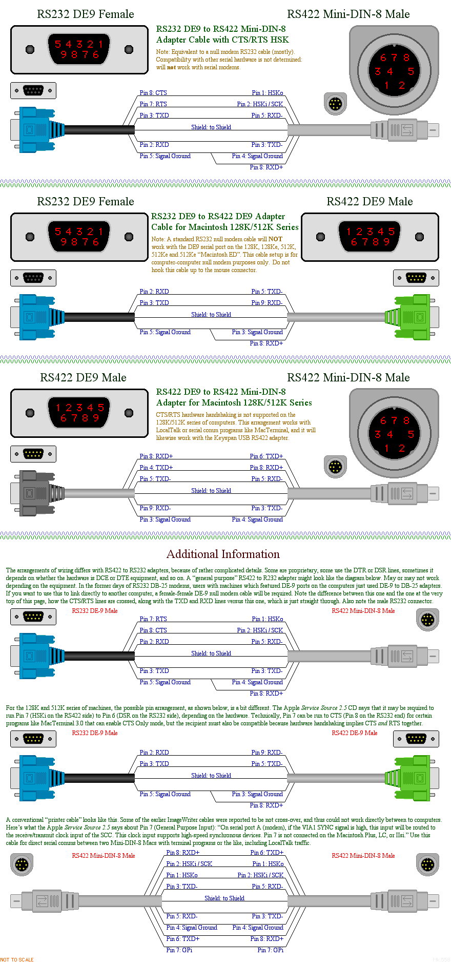

Mk.558
An Apple "printer cable" is shown at the bottom of this image.
