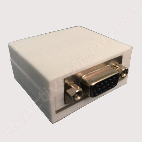

This might work, if you want to use a VGA monitor...
