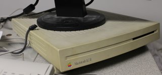

I was talking with a friend today and I asked him if he still had a few things he told me about a while ago (old mac hardware). I picked up today:
Macintosh LC II w/ Unknown RAM (2 sticks kingston), 160MB SCSI HDD, Floppy and PDS Ethernet card.
As well as an AppleCD SC CD-ROM (Caddy load). I don't have a caddy so I bought one off of ebay. This is an Apple Original. The items are pretty yellowed. The caps on the LC Might need to be replaced, however the Battery has not exploded. The PRAM battery looks to have expired on 1998 for the expiry date. So it probably wasn't the original. that said it wasn't a Maxell battery. It was made in france, looks no-name generic.
I haven't tried them but even though I gave a majority of my vintage stuff to Eisenfaust, I still have a keyboard as well as DB-15 to HD-15 (VGA) so I will try that tonight. Pics will follow of course. I will see what's on it or off the hard drive still works. If it doesn't, I am sure I can get a 9.1GB to work in it. I have a 68-pin drive but it would need an adapter.

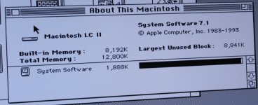

Used a DB-15 to HD-15 adapter with switches. It's set to Mode 1 and 640x480. Would've been nicer if I still had my 4:3 display (1024x768/800x600/640x480) but that was stolen in the honda disaster. I set it manually to a 12" 640x480 mode. So it's locked in that mode. My monitor won't do the 512x384 mode, so the lowest I can do is the 640x480 on LCD. It's doing 256 colors.
The LC II is very slow compared to most other macs. Even the LC III and Performa 450 is much faster. Click responses are horribly slow. I need to reinstall the OS but I am going to have to see my friend Eisenfaust to make the appropriate stuff. I also need to get the CD Caddie so I can put the installers on a disc.

Well, I ran into a snag. First, I did get a SCSI dvd-ROM drive mounted with CD Sunrise. It didn't like my CD of the software for the installs. The second thing is that the AppleCD SC does not recognize discs. I cleaned the laser with alcohol and a q-tip. no change. I also used a pressed CD. It just spits discs back out.
Third, the LC II internal HDD keeps spinning down which when I press on certain areas for the power cable for the HDD, the HDD will spin up or spin down. I suspect a cold solder joint. So I am probably going to bust out my iron and redo the solder connections on the logic board and the hard drive to see if I can get a stable connection.

Sorry for the late reply. I tried to solder the HDD and it didn't go for power. I am guessing either caps or bad solder points on the LC II board for the HDD. If I press on the cable to the HDD for power, the drive will spin up or down. It's possibly a loose joint somewhere, and I will take a crack at a later time to the molex adapter on the LC II logic board.

I did find a SCSI CD-ROM in my collection (8x CD-ROM from apple) that I was able to mount the CD I had and I did get 7.6.1 installed on the LC HDD. It's an 80MB Conner SCSI drive. very slow. I got the LC to mount the CD by taking the network access disk, getting rid of the networking stuff (chooser/extensions) and stuck the CD-ROM extension, as well as the HFS and Foreign File Access extension on the floppy and booted from it. It allowed me to read the CD-ROM.
Oh and I also found out the LC II boots from CD. The disc I have however doesn't have a system folder so it wouldn't boot from that (hence why the DVD-ROM wouldn't boot from it).
So it has an OS, and Ethernet card, 8MB RAM, 256KB VRAM (256 colors @ 640x480) 80MB HDD, sound works, no whine. probably needs to caps replaced (from power issues I guess unless it's a cold solder joint) and the floppy works great (no stiction/etc...)
