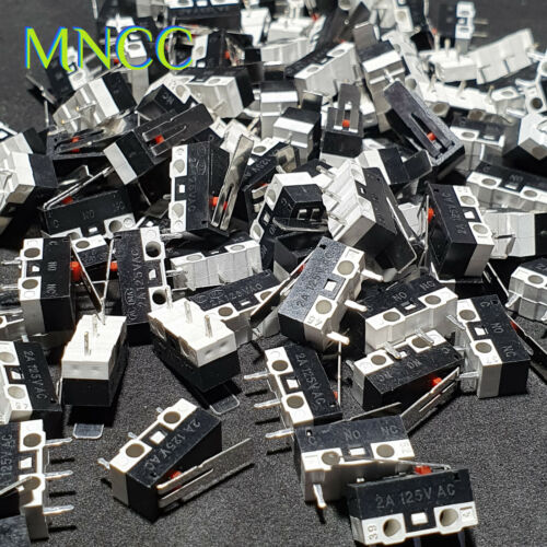

Old thread I know but where did you source the microswitch? I think one of mine is broken... They're both supposed to have lever arms on them right?
