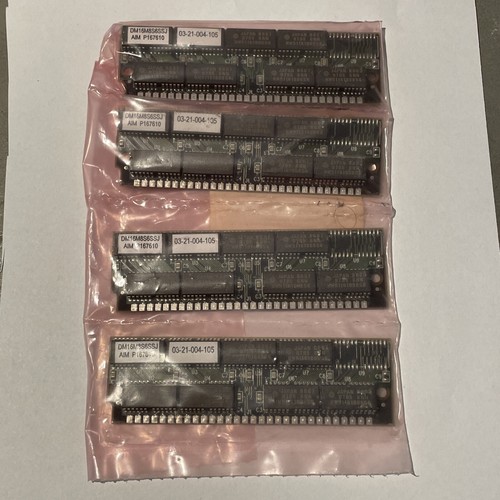

Would this RAM work in a IIsi?
Thats not easy to answer. Infact, with manufacturers changing what chips they use, Its basically impossible to answer.
The best answer I can do is perhaps, but the probability is better if you get 8 chip simms.
Thanks for the help! I’ll get those, they’re cheaper too!

I take it back - they're 16mb simms, so you'd need 4 sets
Ooh. So what would one stick do? Do you need 4 matched ones for any to work? Haven’t ordered anything yet don’t worry.
IIsi, like all '030 Macs with 30-pin SIMMs, requires a set of four in each bank (in the IIsi's case, there's only one bank). I ran one of my original IIsi machines with 16MB in bank "B" for a couple years. Made it more useable than it was with the original 5MB. My third IIsi, I put a set of four 16MB SIMMs into it. So, had a total of 65MB. Except for the long wait for the RAM check, it was entirely useable, if a bit pokey, since I was running Mac OS 8.1 on it. Yes, with the Born Again patch used at time of installation.

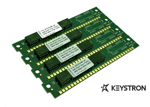

You need 4 matched sticks. Its a bit of a mess in that era of RAM over what does and doesn't work, but I think macs didn't get more forgiving until the Quadras, and even they didn't like some SIMMs possibly.
4 of these would work :
And that would give you onboard RAM plus 64MB for 65MB.
$40+ isn’t in the budget right now but those seem to be the ones to get. Remaining tech budget has to go towards a big cap order for now though, IIsi will have to wait. Thanks for the help folks!
