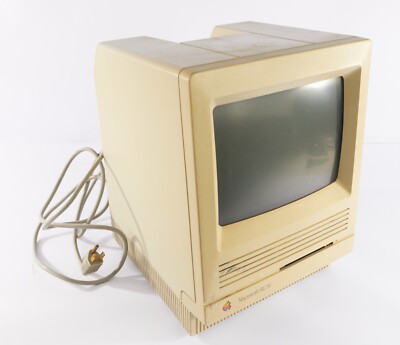

Excited to have a second SE30 on the way. I went ahead and got this one because -
The case looks to be in great shape.
It does not "appear" to be battery bombed. You can zoom in on the profile pics and at least see that the chassis by the battery appears to be spotless.
The video issue might be easy to fix. Hopefully just a detached neckboard or something simple on the Analog board. And I have SE's with perfect CRT's and Analog boards I could replace those with.
Good price if I can fix it. What do you think?
battery is an unknown. always a gamble with that one, but no obvious corrosion from the outside is a good sign.
display not turning on is probably UE8 or one of the others beside that one. it's right beside a capacitor and often is destroyed by the leaking electrolyte.

Yep looking forward to seeing what kind of mess we hopefully don't have. Sony power supply too.

Would a bad UE8 completely take out video altogether or just cause anomolies?

i think in some cases it causes corruption, and in others it just kills the video completely.
