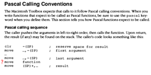

I found this in the THINK C manual. Is the "move function" supposed to be "jsr function"?

And yes, looks like you found a typo in that assembly code fragment.
