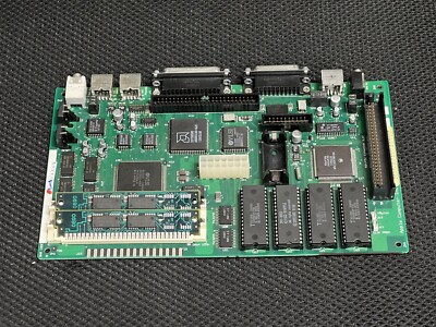

Dear people of 68kmla,
I am writing because of a broken SE/30 logic board.
In 2011, the board has been recapped, not choosing SMD parts sadly, and by removing the original caps, serious leakage has been discovered.
Also, no cleaning has taken place.
(Cfer https://68kmla.org/bb/index.php?threads/se-30-still-simasimac-after-full-recapping.42178/).
However, some ICs also show signs of leakage effects and may need cleaning or even replacement.
To not make things even worse, I would like to give the board in the hands of someone who is experienced in that kind of work. Of course, I am willing to pay for it.
I am located in Germany, so if someone resides in Germany or the EU would be great to have bearable shipping costs.

Offered retrofreak83 to repair the SE/30 board. I am in the Netherlands.
He sent me the SE/30 logic board, the package arrived 7 november.
Checked the board in one of my systems and got horizontal lines, removed the simm's in bank B, still horizontal lines, cleaned the ROM contacts and got it to boot.
Booted with Bluescsi.
Placing the bank B simm's back results in horizontal lines, the simm's are ok, tested in another se/30
Guess there is some address line or other connection to the simm's broken.
Started removing some of the 'artwork'.
Removed all of the modifications and cleaned the board a bit.
Created new pads to replace the missing pads using wires to the next via
Added new tantalium caps
Also cleaned the pins of UE10, not sure if I should remove it from the board and clean underneath
Update

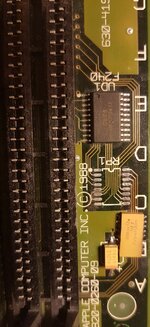

Found the problem with the ram, there is an almost short circuit (80 ohms) between RASA1 and RASA2 on SIMMs 3 and 4
all other signals to the SIMMs seem to be connected OK.
Traced the problem back to RP1, RP1 has an internal short somewhere (pins 10,11,12 < 80 ohms), removed it from the board
Don't have any in stock, so have to order some.
Took 10 days for the part to finally arrive (from the US), is a lot of shipping cost, but this specific/exact part is not available in Europe.
Soldered it on, checked all connections, booted and the board works with 8MB RAM
There still is an intermittent problem with the ROM, will check/resolder the socket tomorrow and test again.
