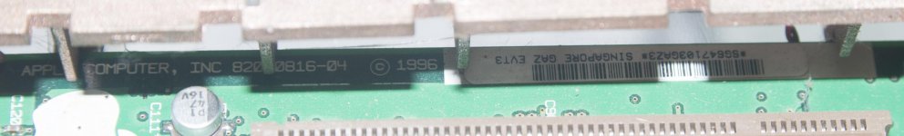

Unfortunately my TAM's LCD got shattered during the earthquake or move and my PSU for it has hid itself in the garage but I'd like to dump the ROM and such off it.
I seem to remember reading once that the 6400\6500 boards are the same as TAM boards with only the external ports changed. The edge connector looks to line up with the one from my 6400 and my board has all the ports (including SCSI) so I'd assume it's just based on that.
Because I don't want to screw up a board I'm just looking to confirm that you can, in fact, throw a TAM board into a 6400's case.
The TAM has no external SCSI connector. The only fitment issue I can see is this small board added. Here is a pic from another thread. If it looks like it will fit, it probably will.

Mine's actually an EVT and has all the regular ports on it and doesn't have that small board.
Knowing it should work fine in a 6400 case is good though as it's far easier to make sure the board works in that than in the actual TAM chassis itself.

Related to the hardware though: The motherboard works fine in a 6400 case. It seems to be a revised 6500 board, complete with a 200 MHz 603ev (not 225 or 250 MHz 603e). 3D Rage II graphics, no onboard ROM (SIMM only) and regular 6400\6500 ports. The ROM is actually a stock 6500 ROM however there is a ROM flashing program that was on the original HDD that has the "Gazelle ROMondo" file, which is the stock 6500 rom.
