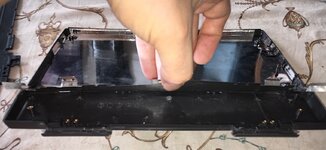

top, display
bottom, 3d printed display shim, with four extra clips in case mine would brake during the disassembly( didnt need it)

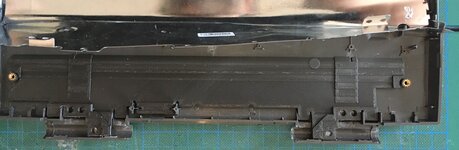

LaPorta also did a good writeup.
front bezel removed, I only broke one little piece of pastic, but it still closes.

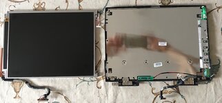

monitor removed, there are only four main screws which holds it in place.

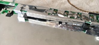

on the right the inverter board.
