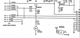

My initial thought was that the PSU is overloaded. I've only scoped the 5V line but did not see any sag on startup. I have not checked the other rails and I'm not sure whether the Turbo 040 would even use them. My other thought (before I did a lot of testing with the boot floppy) was that it was related to some setting in the SCSI2SD. I tried adding delay, different modes, etc but it always produced the same results.

That's another good point. Both of my faulty-config ABs are also recapped (with the same caps) so I shouldn't rule them out, either. On the 5V rail itself it looks like there's just a 100 uF cap in what looks like an RC filter for the AB, but it's certainly possible the other circuits on the AB using the 5V rail could be impacting things.
