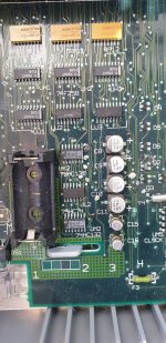

Based on quick look the boards are somewhat ok but would need cleaning and recap. I am hoping to get one perfectly working unit and maybe second one if I manage to source missing bits for it. The photo is from a non-working unit.

Recapped the worst looking IIcx board first. I didn't try it before hand as I was told it being totally dead. After recapping it starts up fine but no chime from loudspeaker or headphones, no video, no disk activity.
The corrosion on pads was pretty bad and I two caps fell off during the initial wash. It was pretty difficult to find some clean metal but I managed to do all electrolytic SMD caps. I guess there are some broken traces as well.

On machine A (soldered CPU, recapped and washed now) I found two broken traces to near audio circuits, that would explain no audio at startup. But I haven't seen anything related to video issue. Maybe I'll fix the audio traces first and then I might be able to head some dead mac chime.

No clue why machine A is not working, I haven't found any broken traces yet...
The machine B was much easier to recap and it is now in working condition. In addition of new capacitors it requires a sketchy jumper wire to bypass corroded trace. ADB, soft start, floppy, video and sound all work nicely. I haven't tested SCSI yet.
