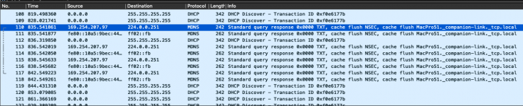

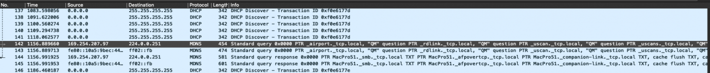

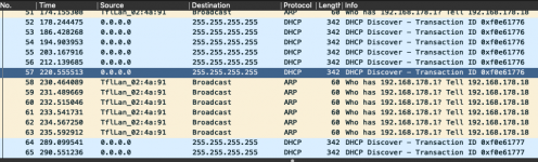

I am not quite sure, what's going on between those two Macs, so I thought maybe I sould try Wireshark the connection and look at that.
I am not a profi, but it looks like to me, that the Performa tries to send an ARP request, trying to find my MacPro where the FTP server is hosted. And apparently, it doesn't get a response from any device in the network, still, there are those DHCP Messages, which I can't really explain. Because the 0.0.0.0 source IP would indicate that the destination is unknown.
After a while, this popped up, which I can't really make sense of. But as far as I understand it, this MDNS is some kind of special DNS service that directly talks to devices. But apparently, it comunicates via IPV6, which my Performa can't handle.
Maybe someone can make sense out of it.
