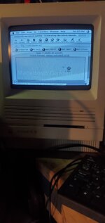

I've recently gotten my SE/30 up and running with Mac OS 8.1, and I have been trying to push it to the limit, on a budget!
Hoping for internet connectivity, I've been following a few tutorials around the web on how to network a Macintosh
using a USB/Serial adapter, an RPI and Slirp. I have had a heck of a time getting this working but I've managed to push 38400 baud through the modem port successfully and load some web pages.

It's pretty neat I say give it a go! I just pushed it to 57600 and things seem to be working well. I've been playing around with WRP and it loads surprisingly quickly (for what we're working with)
