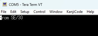

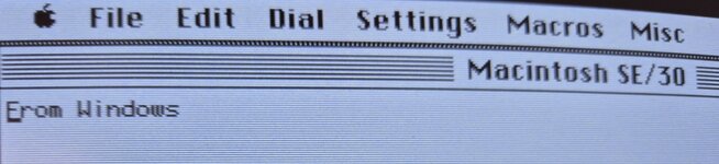

I was thinking of testing out a serial cable in order to be able to diagnose motherboards when needed (inspired by the video Adrian Black posted a while ago). Using ZTerm on the Macintosh side and Tera Term on the PC/Windows side to verify the connection first. Adjusted the settings the same way Techstep is supposed to be communicating (9600/8/N/2 (and no flow control)) and I can write text and receive text without issues. When booting the Macintosh and pressing the NMI switch it seems "OK" until I start to type characters on the Windows side, then the Macintosh starts to output continuous junk on the screen. While testing this multiple times I've been able to see that the junk can contain the identifier string for the model. I've attached some screenshots if anyone here has a clue of what might be wrong? I mean communication obviously is working with the terminal programs so the cable must be correct I guess?
Tera Term - received text from the Macintosh:
ZTerm - received text from PC/Windows:
