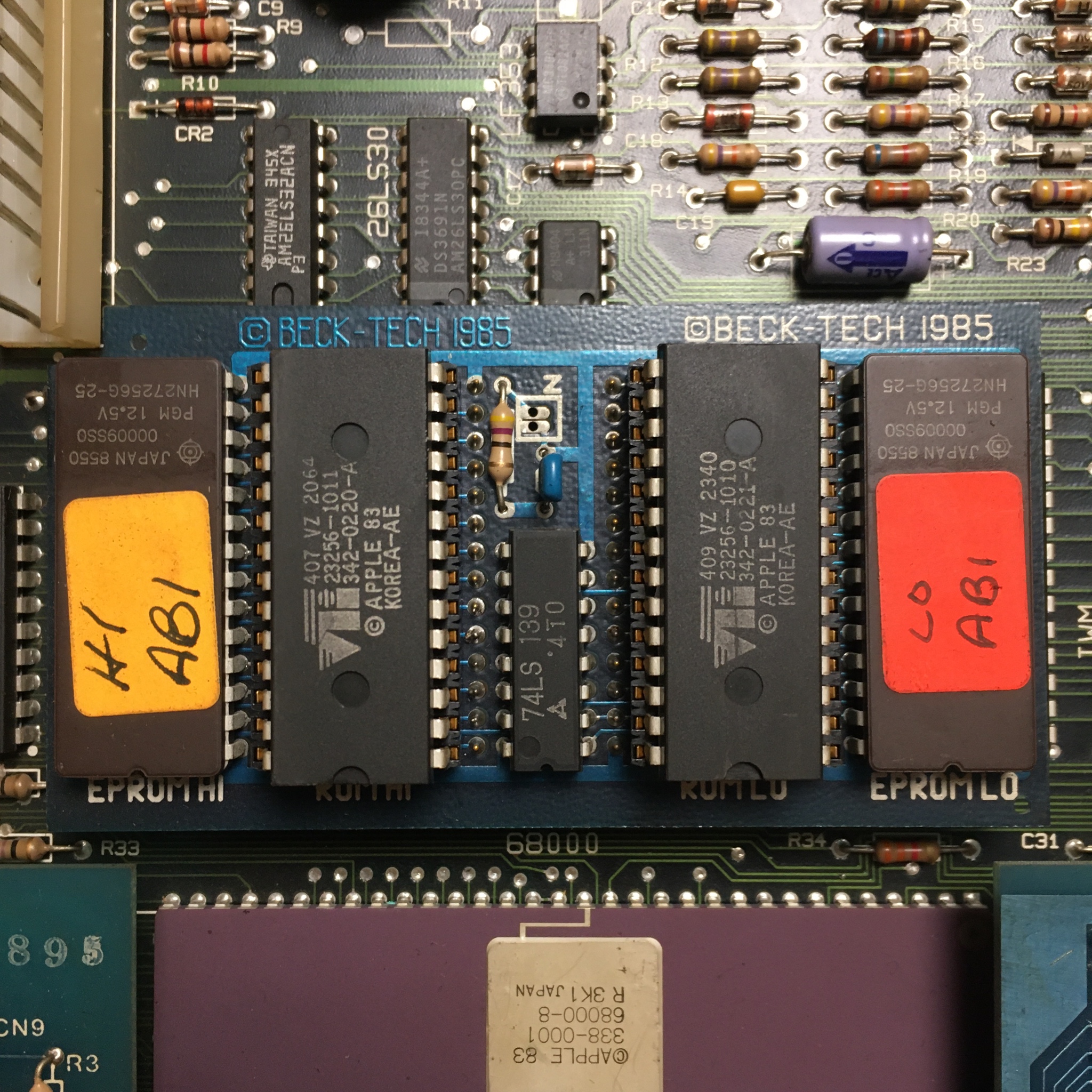

The Beck-Tech MacMEGABYTES used a second set of ROMs to patch the 64k ROMs
That makes sense, thank you everybody!(y)
