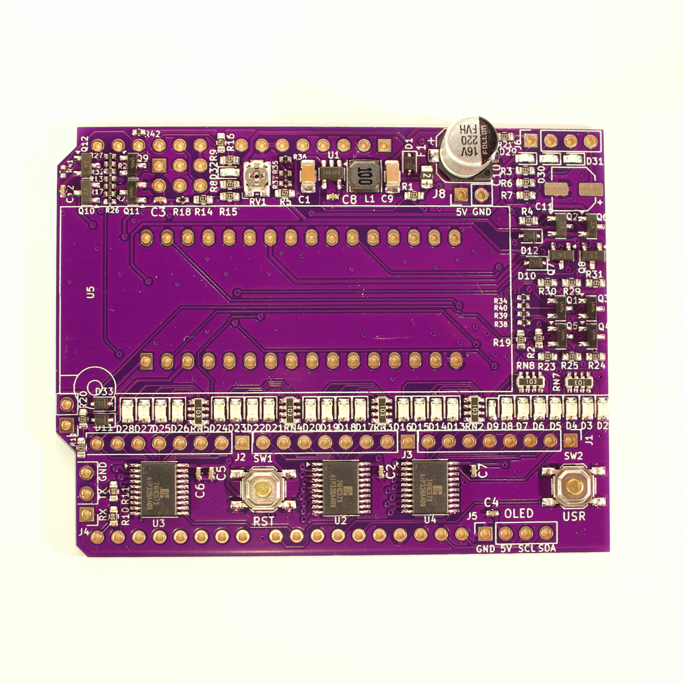

Hello everyone. I purchased a Mac Plus Rominator. I have soldered the parts together but when I install it I get a checkerboard screen. I think that I might have screwed up the ROM chips. What ROM programmer should I purchase to reflash the ROM chips? Here are some pictures of my work. Let me know if you see an issue.IMG_2078.JPGIMG_2080.JPG
I did try toning out the pins and lines. I do not have a diagram to verify the proper signals but for the most part the tones line up with what I think is correct.
What do you think could be the problem?
Where did you get your ROM programmer? Also is there a file I can use to tone out my board to make sure my solder joints are correct?
Gerber files for the Rominator are available, but not the schematics. I would ask the vendor for them.
If they can't provide you with schematics, I would be happy to draw them for you from the Gerber files.
