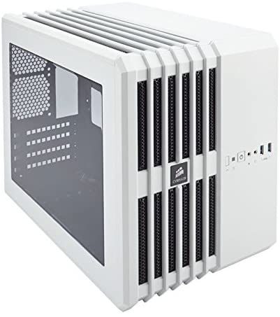

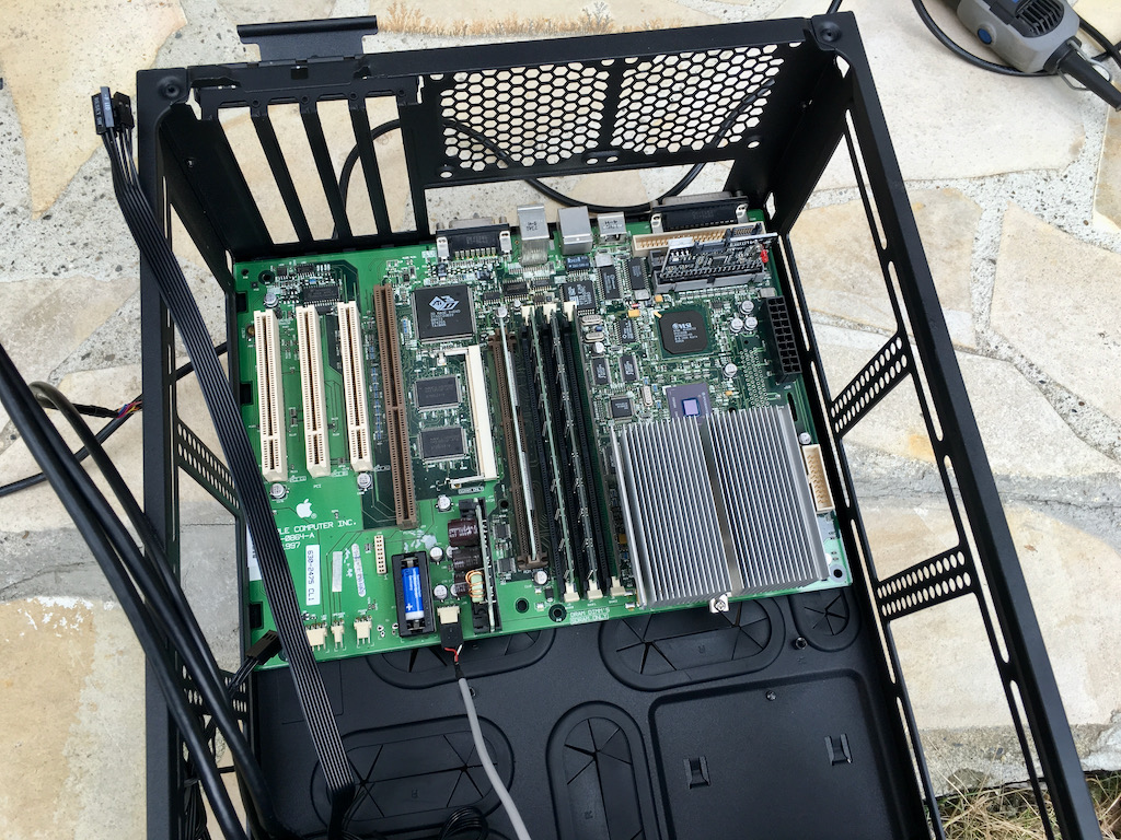

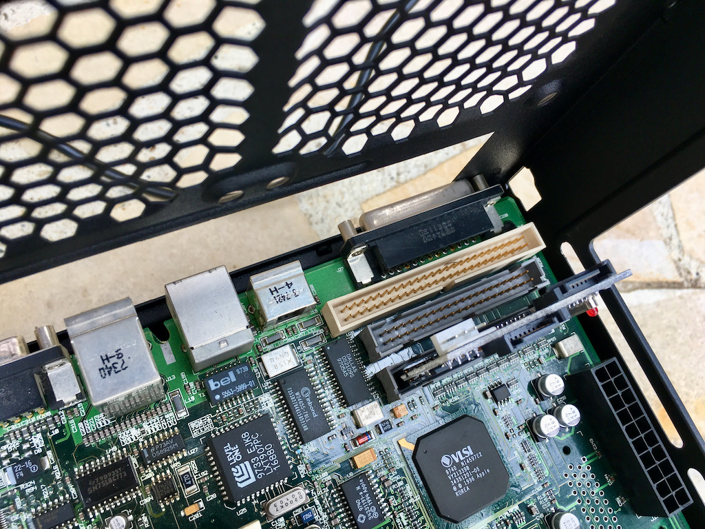

More than 10 years later (2016), being impressed that this Mac was still running, I decided to put it back together in a more clean build. The chosen case was a white cube : Corsair Carbide Air 240.
The motherboard was almost fitting without too much issues
I had to cut a little bit of the backpannel to fit the SCSI Connector :

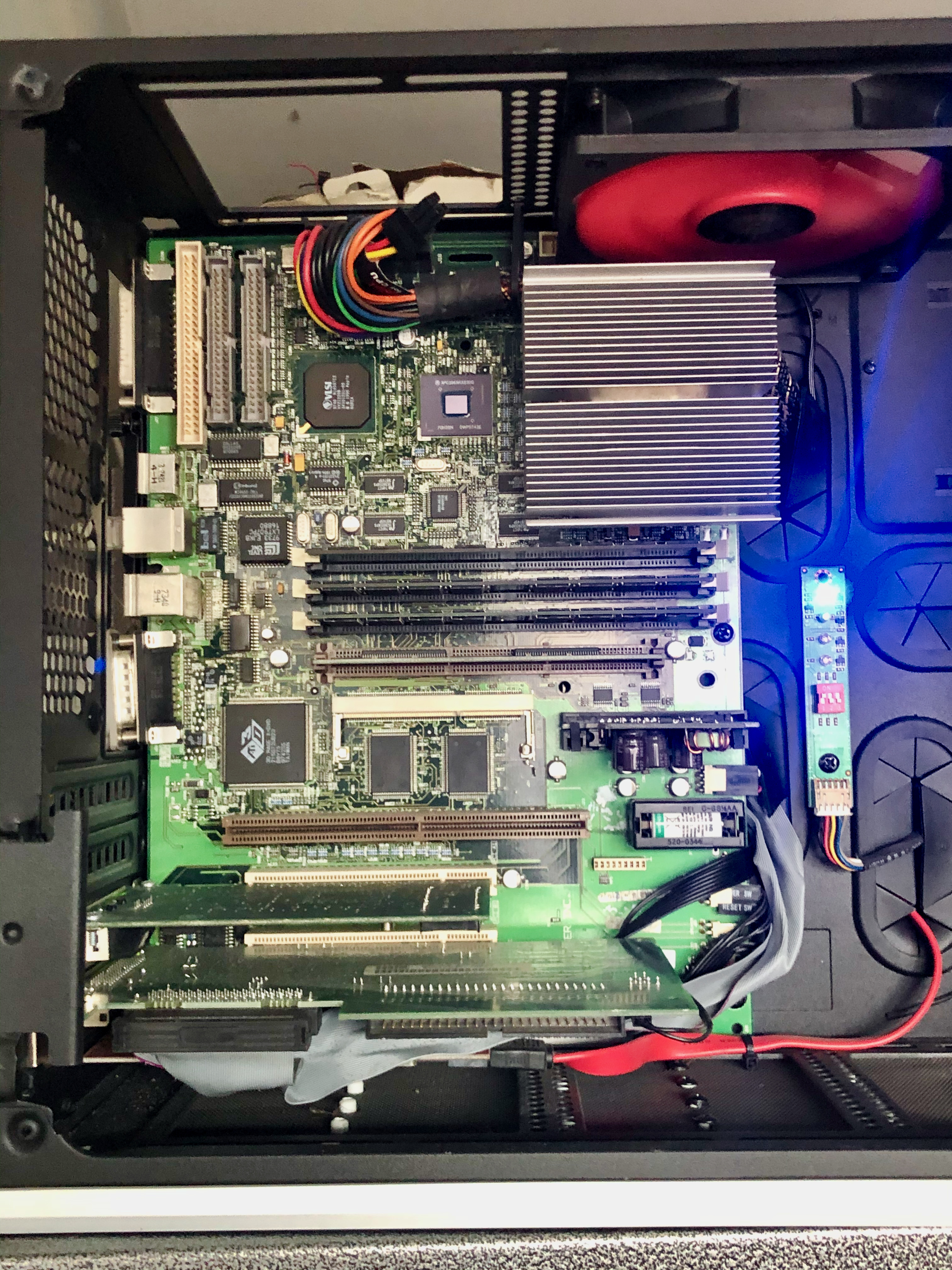

An inside view:
- The blue led board is the hardware SATA RAID Controller
- The CPU coller comes from an Athlon XP system, with the fan removed

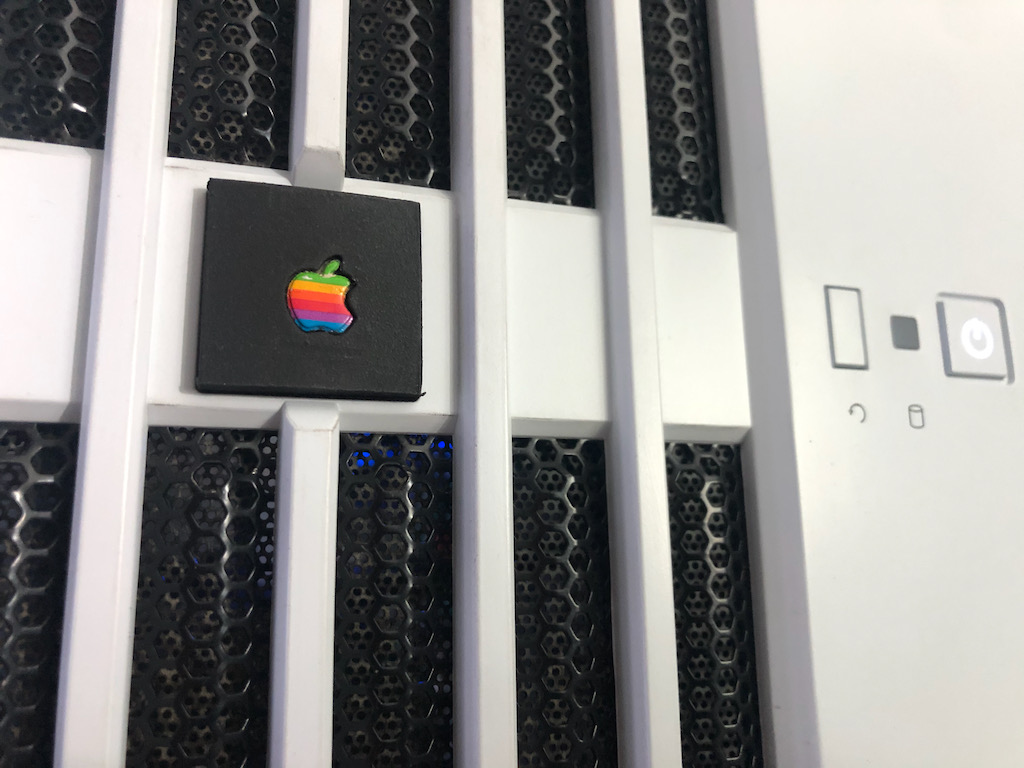

It gained an Apple Logo on a front, courtesy of a broken Quadra 800 Front panel

The whisper personality card shield was missing
Sorry for resurrecting this thread, but not seeing a personality card in any of the photos, did you ever fit one? I'm wondering about clearences on the rear openings.
The sound chip is on the card, so I guess that means you don't have any sound?
I believe later versions of Mac OS (9 certainly) crash when they load that Audio extension if you don't have one, but 8.1 does seem to boot.
No worries
I do not have one at the moment because it now has server duties and is indeed booting Linux / 8.1 just fine.
However you are right, that may have clearance issues.

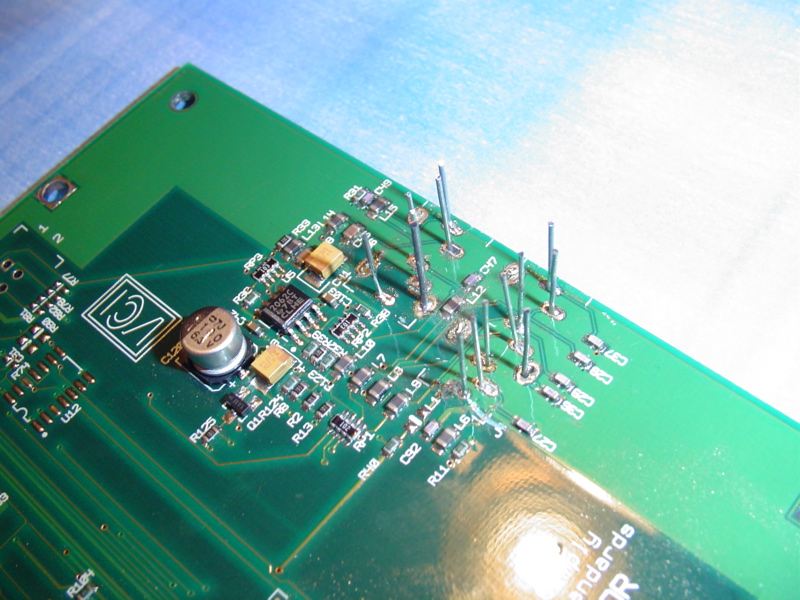

What I did back then is grab another personality card from eBay, remove the jack and put pin headers where the jack where. That way I could use the case HDAUDIO/AC97 front panel jacks.
Horror picture below :
No worries
